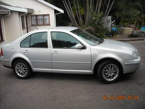

Also - my car is a rep-mobile so I need more rubber between my rims and the tarmac than 18"s can offer.
I'm starting to think that's a good mindset on this one;)Howie-WP wrote:Personally will not mod rims to fit on my car. If rim does not come in correct PCD for my car, will have to look for one that does fit. But that's just me....
That's a bit of awesomeness right there - nice ride.
Thx for the input guys.
