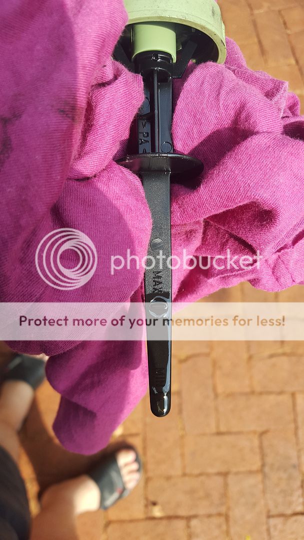

Step 1, locate power steering reservoir and open cap,

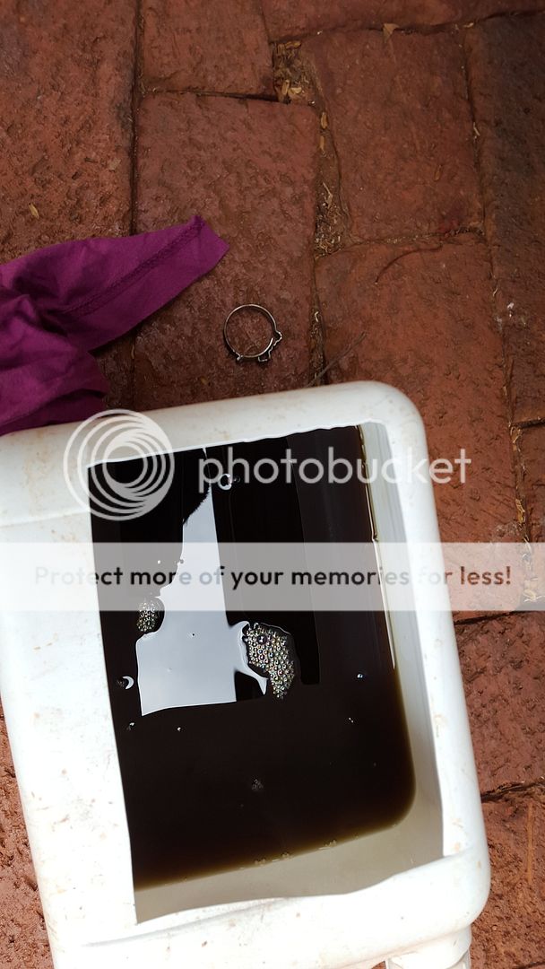

Step 2, drain fluid from lowest point as indicated, simply undo the clamp and pull off the pipe and drain into a bucket,
As seen in the following pic, fluid was black (Supposed to be gold) so dont think it was ever changed,
