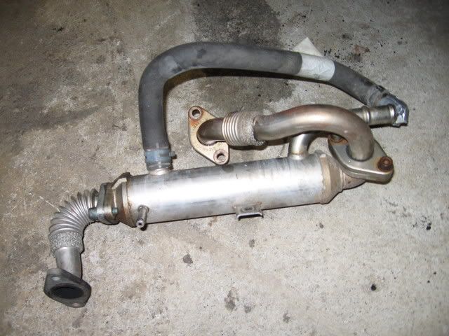

Is the EGR system still in place? It could be something as simple as the EGR cooler has a crack in it and is letting exhaust gas into the cooling system.

Ok so EGR delete, but was the rest of the system also removed?
Looks something like this?

amstel18 wrote:Ok so EGR delete, but was the rest of the system also removed?
The whole egr cooler is removed.
