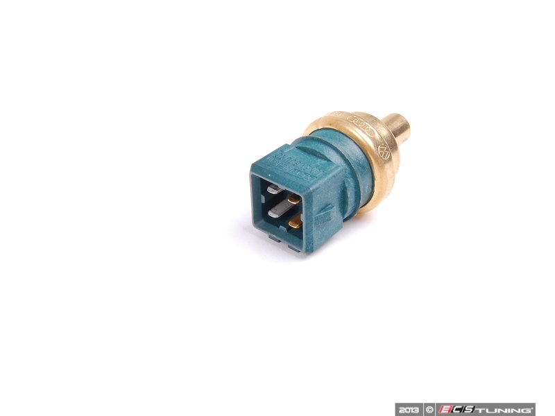

ok guys just to give an update. i bought the temp sensor yesterday at Goldwagen. they first gave me some unknown brand but the plug part was green and half round with 4 pins but short pins. immediately noticed the sensor was incorrect as the plug from the car is a square plug with levers on both sides.
before leaving goldwagen returned it to them. they searched on their database but could not find the correct sensor for my engine. strange as I bought one from them i think 3 years ago. Anyway VW Kenilworth was just up the road decided to get a printout from VW with the part no. and return with that to Goldwagen. VW's quote was R521 i might be a few rands out. When I came at GW their kind of looked puzzled as if that specific sensor was incorrect. I left GW with the part priced at R107 fitted it last night. Havent gotten any rich petrol smells yet but I know its a bit too early to tell. so will drive car for a while and report back again.
will post a photo of the sensor i bought at GW.

so this is the first sensor they gave me
this is the second one, the one i fitted last night, except that where the yellow strip is its blue. the agent at VW asked me if my old sensor has a blue strip in

MacMan
Posts: 4098
Joined: Sun Jul 28, 2002 12:05 pm
Car Model: MKV GTi
Membership No: 478
Location: Jo'burg
Re: Dying spark plugs
Postby MacMan » Tue Sep 16, 2014 11:04 am
What year model and engine code?
'06 UG Golf MKV GTi - 208Hp / 322Nm @ KAR (DP + Intake)
| DIY+ | S3 short shift | Flowtech DP | ITG Maxogen | REVO2 | Autotech HPFP | RCD 510 | H&R |
'04 Golf MKIV GTi.:R
'99 Citi Golf 2.0i
Patience is the ability to idle your motor when you feel like stripping your gears.
FM1
Posts: 874
Joined: Mon Jun 05, 2006 3:34 pm
Car Model: Fiesta
Postby FM1 » Tue Sep 16, 2014 11:05 am
MacMan wrote:What year model and engine code?
99 AKL
FROM ROOTS TO TREETOP
Current: Ford Fiesta
Ex: VW Golf 4 1.6
MacMan
Posts: 4098
Car Model: MKV GTi
Membership No: 478
Location: Jo'burg
Postby MacMan » Tue Sep 16, 2014 12:42 pm
99 AKL
Diesel right?
According to ETKA your car either takes a blue or green sensor depending on VIN number.
Blue: 059 919 501
Green: 059 919 501 A
