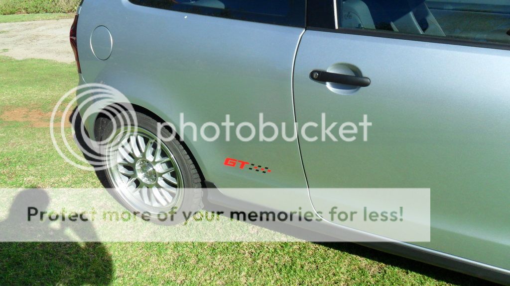

Impi
Posts: 76
Joined: Sat Feb 23, 2013 6:38 am
Re: Polo Vivo Gt
Postby Impi » Mon Feb 25, 2013 6:59 pm
Hi I got the cover today and it makes a huge difference.
Before
After
The Car
Will post the Pn later
