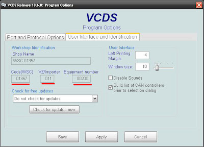

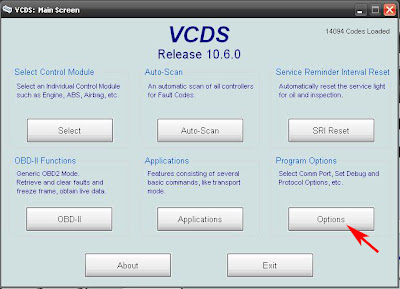

- Select the "Program Options" and on the "User Interface and Identification" tab make sure you have similar values as per below right. They don't have to be exact, you must just have values, otherwise certain modules will not accept coding from VCDS.
- Apply, Save and then restart VCDS.
- Once VCDS has restarted select the "Control Module"
