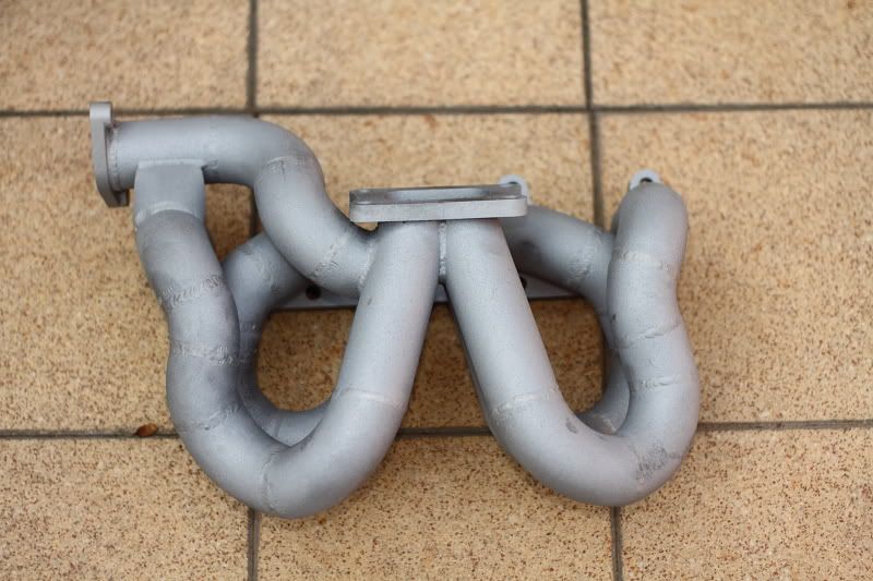

No probs. Also remember the 20V head flows a hell of a lot more on the exhaust side than the 8V head does, so a direct comparison is a bit unfair.
With a cast manifold, the spool on my setup will be even sooner, but will lose out on higher revs. The runners on this exhaust mani are about 400mm long compared to a cast manifold that is +-170mm long on the longest runner.
Pic:
