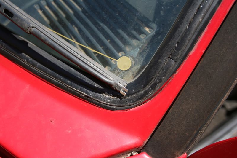

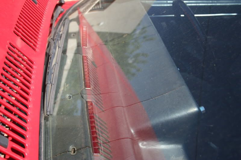

Some pics of the damage :(
Munched wheel arch - ouch
Slight dent and what happened to exhaust opening??
Not sure what this means but is looks a bit ugly
Evidence of overspray
Boot lock - had a bad day somewhere?
Cracked dash
Radiator all loose
Console in pieces
One lug nut missing!!
and no spare - just three tires??? Anyone got a spare 14" 4x100 steely I can buy

ok the seats is a direct swop, shocks are a bit tricky you need spring compresors, the dash can be fixed but wat ever you find in the scrap yard will be the same, i would say keep it put some money into it make it you project make her look good again so good luck

MadMax101 wrote:the dash can be fixed
How do you repair them?
