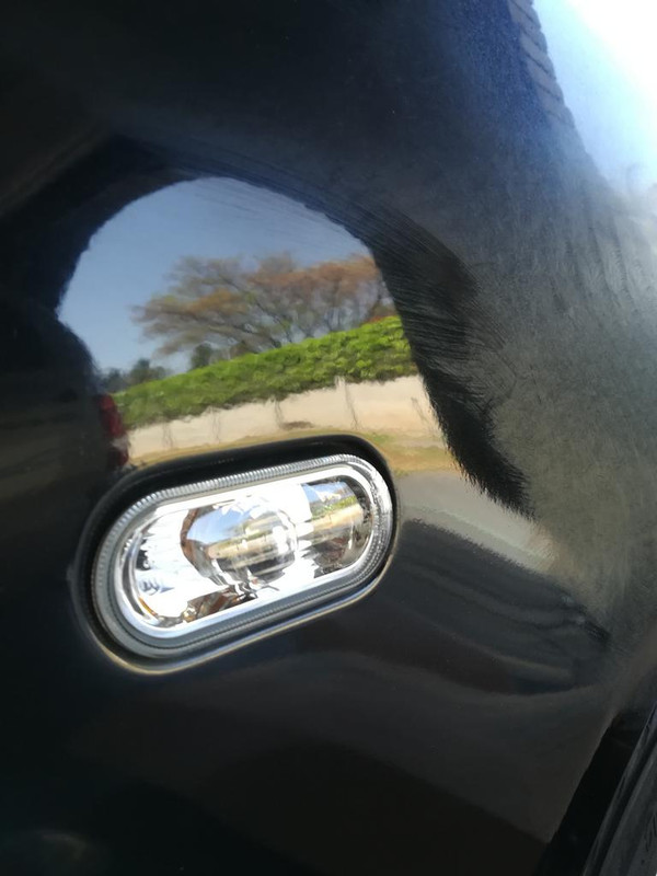

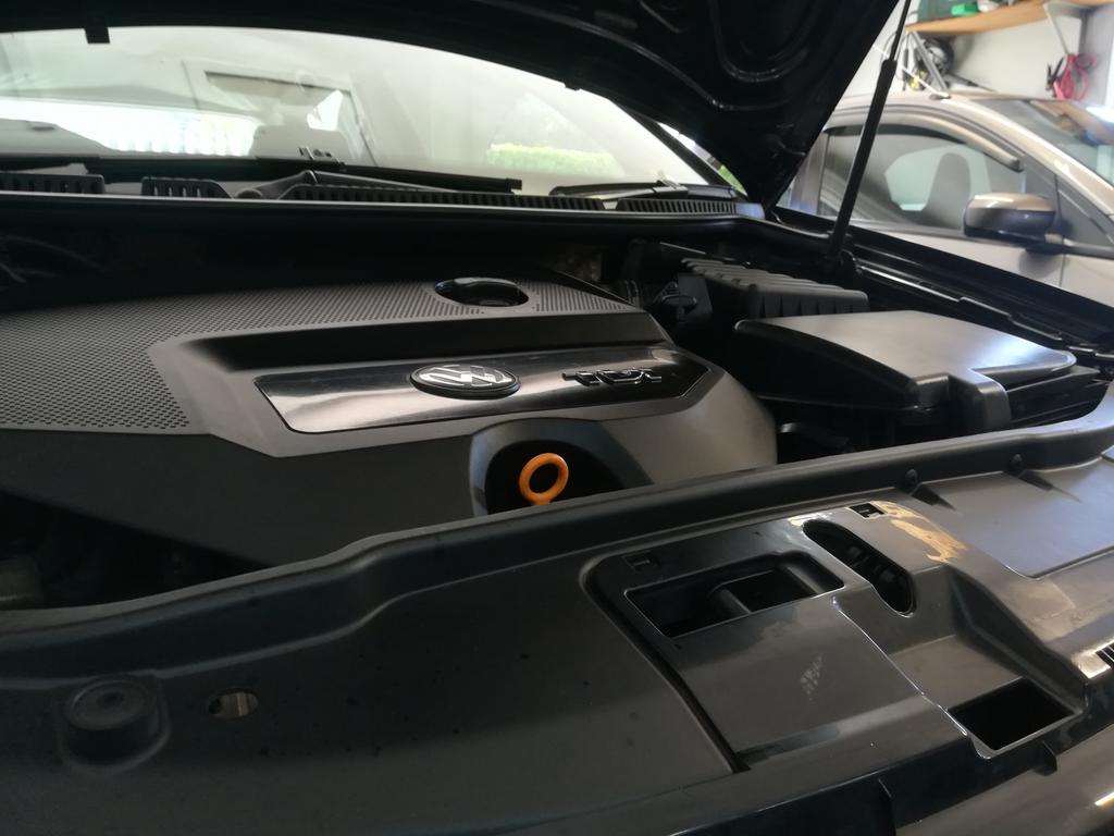

Guys I need to know....
I bought a black Polo 9N TDI.
The paint is not shiny. I have washed it by hand maybe 10 times in the week since I've had it, and polished it 4 times, i used MiraPlate, and Holts colour specific black polish. Now, it looks better already, but still a far cry from being as I want it. The car is not in a horrible condition, but it has been neglected a fair bit. In the photos below it actually looks amazing, but in the day light under direct sun, it is still fairly dull.
I need to know, what can I use to bring back the shine, without breaking the bank?
Will a clay bar do the job, will it bring back the shine, or is a claybar only to properly clean it?

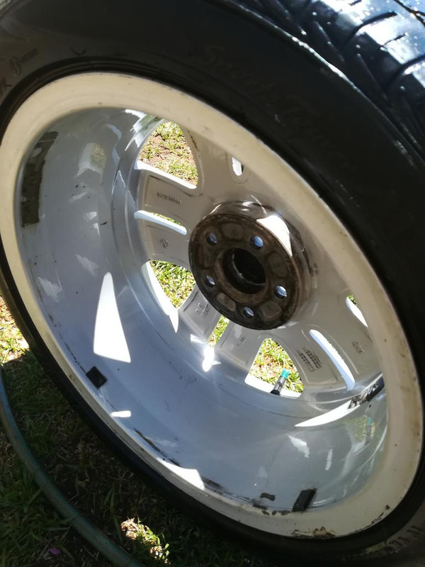

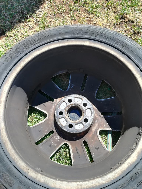

Cleaning the inside of the wheels:
Painted the calipers and polished rim paint and polished lug nut caps:

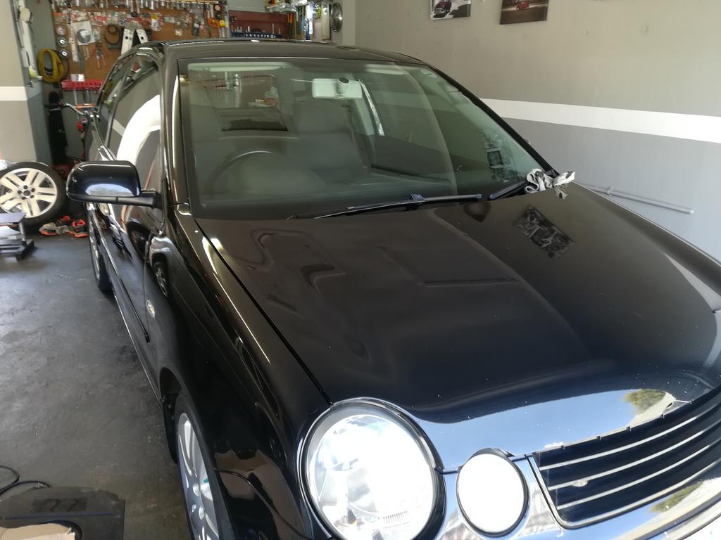

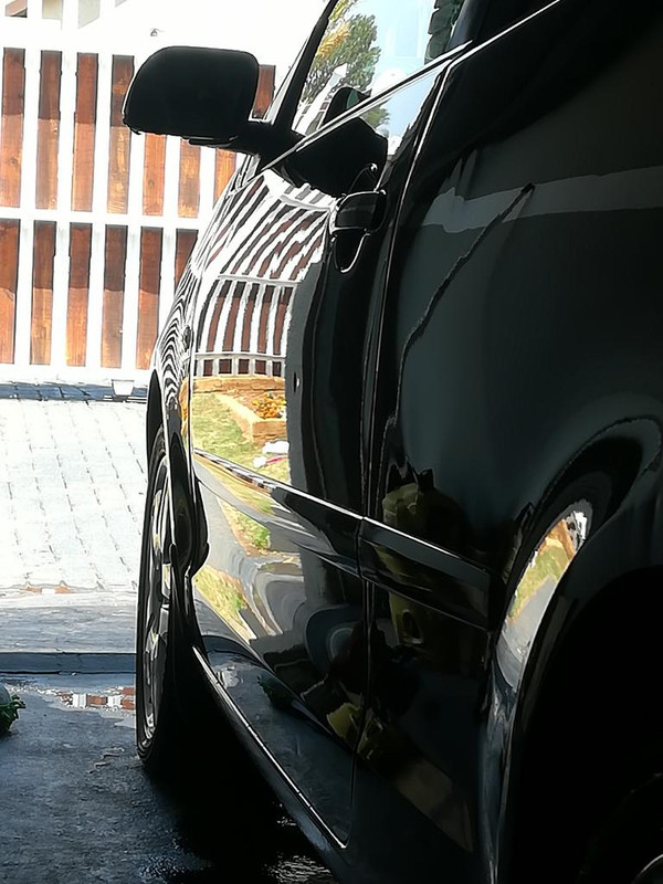

Polished paint work
During:
After (Just look at how dull the bonnet is):

Firstly, you are over-washing the car... and in so doing, are most likely making the paint LESS shiny by instilling swirls through poor washing/drying techniques.... you should not need to wash the car more than once a week.
I suggest you read this as a starting point https://www.vwclub.co.za/forum/viewtopi ... 0&t=166322
casperjjordaan wrote:
Tue Oct 02, 2018 10:56 am
My last car was polished 3 times in 5 years and I can promise you it looked more 'shiny' than most cars on the road during that time... every time you polish your car you are abrading away the very finite amount of clear coat.... you want to polish your car as LITTLE as possible...
I also suspect you are not getting the results you want because you are using sub-par products...and presumably an ineffective technique.
VW paint tends to be on the harder side and so to REMOVE scratches (swirls are fine scratches instilled through washing/drying) you need a fairly aggressive combo - working by hand with bad abrasives is not going to cut it (pun intended).
I suspect the car needs a proper paint correction - in other words, a decent polish using a polishing machine, by someone who knows what they are doing, using quality abrasives.
Do you own any polishing machines, if so, which ones
What sort of budget do you have to get the paint 'proper'
Are you adamant to DIY it, or are you prepared to pay someone to do it?
A clay bar is used to decontaminate paint - in other words to remove stuff that is STUCK to your paint that washing won't remove. It will help to a small degree with 'shine' assuming the car is heavily contaminated, but on black paint, it really is a minimal difference - the big difference in the appearance of black paint comes from removing below surface defects (scratches/swirls/etching etc)
