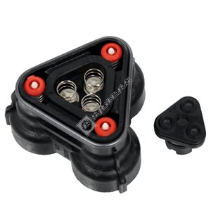

let me show you the difference between a K5 and K7 Cylinder head
BTW - no need to change attachments for the K series. The foamer will work just fine
K7 Cylinder head
K 5 Cylinder Head
K7 Cylinder head
K 5 Cylinder Head
Quite a massive difference in design

have a look at this video to see what I mean
Yes there is steel on top on the head but the head itself is plastic

The K7 Karcher with a higher capacity foam cannon....
After lengthy discussions with the guys from Karcher yesterday, this is what I have been told - some of which (like the duty cycle) I had no clue about
The K7 is the only machine with a brass cylinder head. It is rated at 160bar and has a duty cycle of 1 hour. This means it can be used for a maximum of 1 constant use and then must be shut off for at least 30 minutes - this is a water cooled machine.
The K5.2 and K5.7 supposedly have metal (not brass, not plastic) cylinder heads which are more durable than the plastic ones, but less durable than the K7. This however contradicts the pics Lambchop posted of the cylinder heads, so short of opening up a brand new K5.7 I don't know if the Karcher dude is just trying to pull the wool over my eyes. These are 130 bar machines (so currently too powerful (supposedly) for the new V2 cannons. These machines have a duty cycle of 40 minutes before needing to be shut down for 30 mins. They are also water cooled.
The K4, 3 and 2 series all have plastic cylinder heads, and a duty cycle of 30 minutes, before needing 30 minutes cooling off period - these are air cooled machine.
The K1 series is the same as above but with only a 10 minute duty cycle....
According to Karcher, some of the common causes of the failed cylinder heads are:
1. Exceeding the duty cycle - i.e. working the machine too long before allowing cooling off periods
2. Insufficient supply of water to the machine from your tap
3. Not bleeding the system of all air before turning it on
4. Pushing dirty water through the machine
5. Using 'unauthorized' chemicals in the machine
And then as lambchop mentioned, the constant on/off nature of these machines causes cracks in the cylinder head itself,or the seals therein to fail.
The more I look into this, the more it would seem this is the route I need to go.
